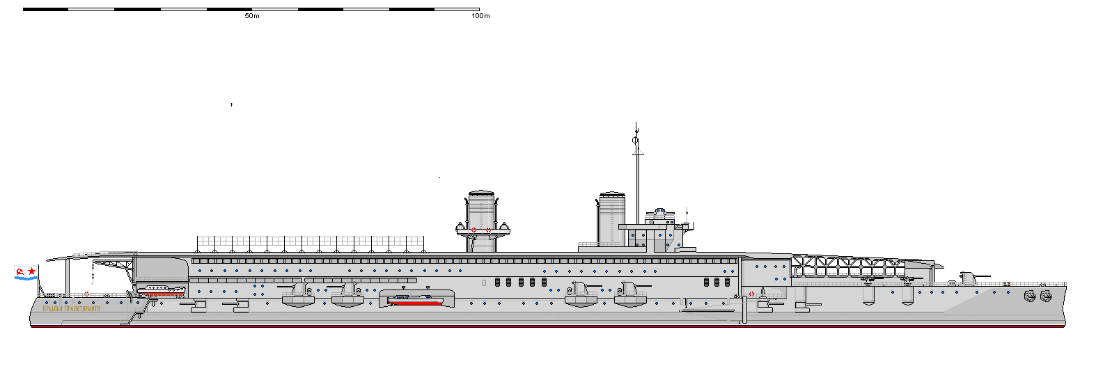

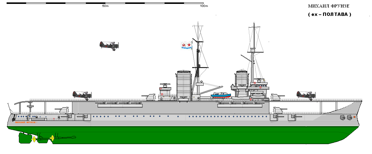

В добавок авианосцы на базе недостроев, в частности Измаилов были и не раз:
Iz_car_1.thumb.jpg.25e119717821cf2e9be34Iz_car_2.thumb.png.0d53348b6d60841491b54Frunze_carrier.thumb.png.381a5f53c903c22Sov_carriers.thumb.png.ea899475848ea8712

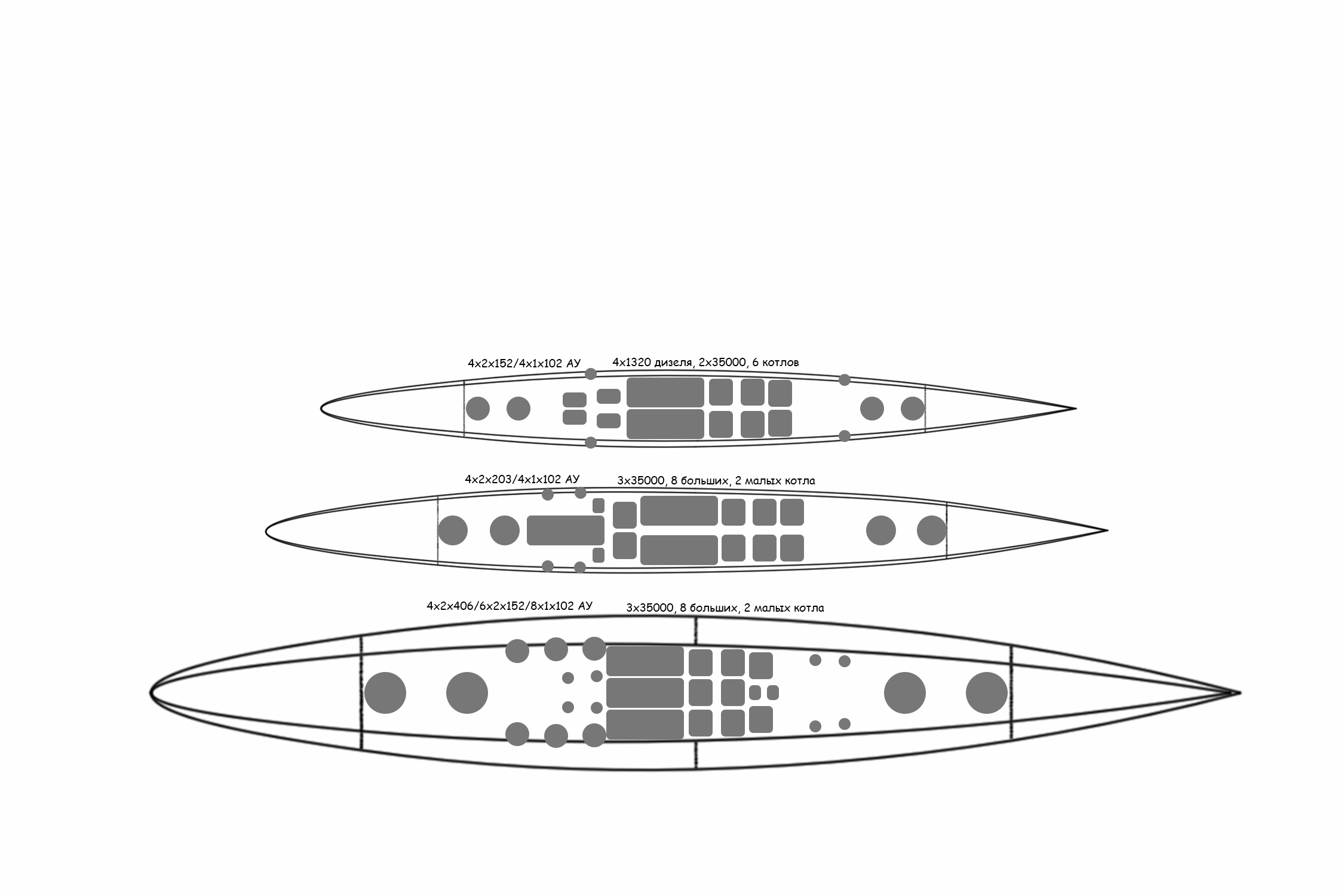

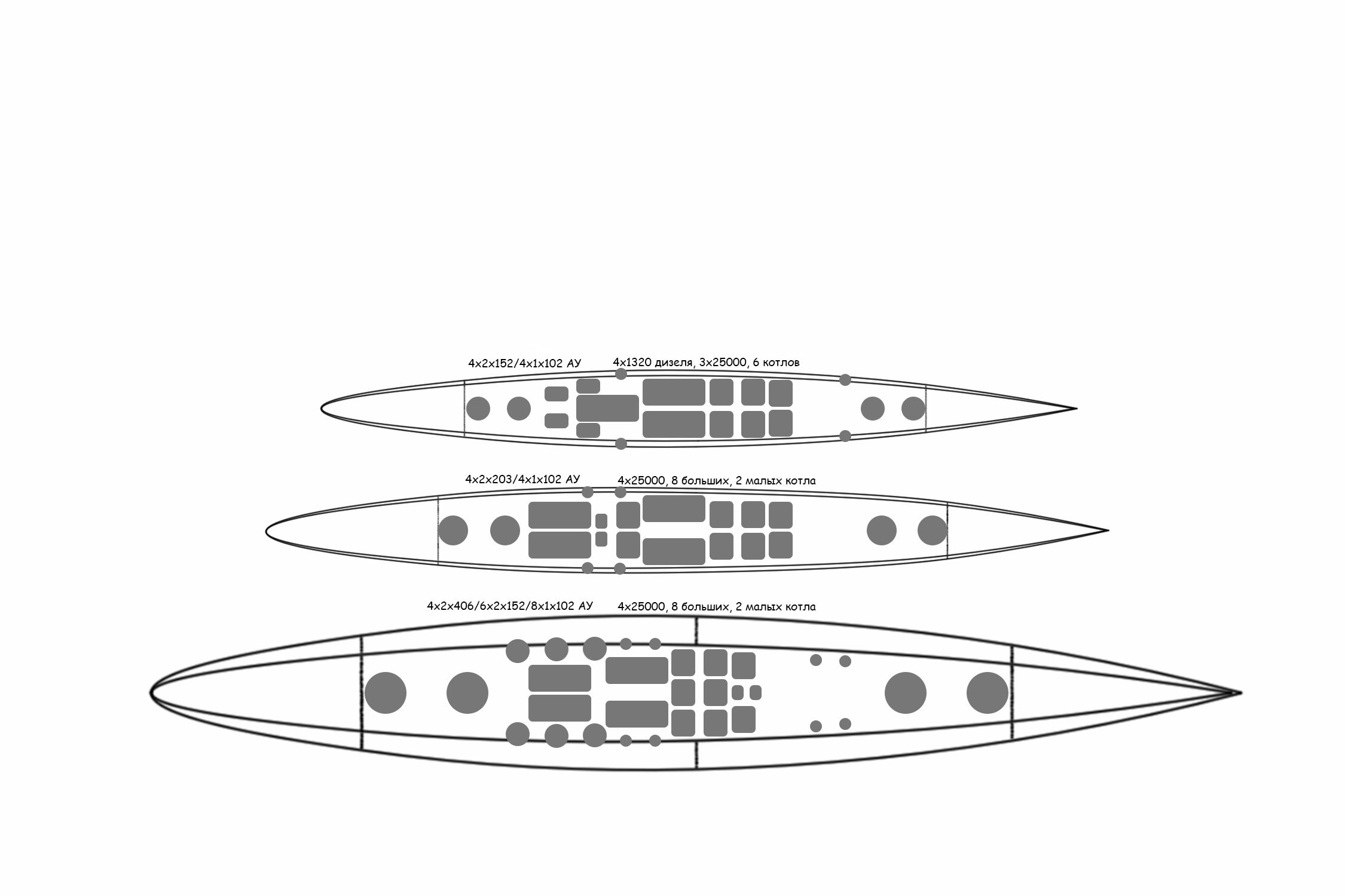

Насчитал тут кстати варианты корабликов
Крейсер рейдер:
"Korsar", RSFDR Light cruiser laid down 1924 (Engine 1926)
Displacement:
                6 807 t light; 7 030 t standard; 7 471 t normal; 7 823 t full load
Dimensions: Length (overall / waterline) x beam x draught (normal/deep)
                (574,14 ft / 556,82 ft) x 53,25 ft x (18,37 / 18,99 ft)
                (175,00 m / 169,72 m) x 16,23 m  x (5,60 / 5,79 m)
Armament:
      8 - 6,00" / 152 mm 50,0 cal guns - 104,28lbs / 47,30kg shells, 100 per gun
                  Breech loading guns in turret on barbette mounts, 1908 Model
                  4 x 2-gun mounts on centreline ends, evenly spread
                               2 raised mounts - superfiring
      4 - 4,02" / 102 mm 45,0 cal guns - 38,58lbs / 17,50kg shells, 250 per gun
                  Dual purpose guns in deck mounts, 1924 Model
                  4 x Single mounts on sides, evenly spread
      4 - 1,57" / 40,0 mm 39,0 cal guns - 1,85lbs / 0,84kg shells, 1 500 per gun
                  Anti-air guns in deck mounts, 1916 Model
                  4 x Single mounts on centreline, evenly spread
                               4 raised mounts
      Weight of broadside 996 lbs / 452 kg
      Main Torpedoes
      6 - 21,0" / 533 mm, 26,57 ft / 8,10 m torpedoes - 1,705 t each, 10,232 t total
                In 2 sets of deck mounted side rotating tubes
Armour:
   - Belts:                                Width (max)           Length (avg)                         Height (avg)
                Main:      2,95" / 75 mm         344,49 ft / 105,00 m              7,87 ft / 2,40 m
                Ends:      2,95" / 75 mm         196,85 ft / 60,00 m                7,87 ft / 2,40 m
                  15,49 ft / 4,72 m Unarmoured ends
                  Main Belt covers 95% of normal length
                  Main belt does not fully cover magazines and engineering spaces // хз что не так, по чертежам должно влезать
   - Gun armour:     Face (max)             Other gunhouse (avg)          Barbette/hoist (max)
                Main:      2,95" / 75 mm         1,18" / 30 mm                        2,95" / 75 mm
   - Armoured deck - single deck:
                For and Aft decks: 1,57" / 40 mm
   - Conning towers: Forward 4,92" / 125 mm, Aft 0,00" / 0 mm
Machinery:
                Oil fired boilers, steam turbines,  plus diesel motors,
                Geared drive, 3 shafts, 75 280 shp / 56 159 Kw = 33,08 kts // из них 5280 - четыре дизеля на центральном валу
                Range 5 000nm at 13,00 kts // 10-12 тыс. под дизелями на той же скорости
                Bunker at max displacement = 793 tons
Complement:
                401 - 522
Cost:
                £2,097 million / $8,387 million
Distribution of weights at normal displacement:
                Armament: 337 tons, 4,5%
                   - Guns: 317 tons, 4,2%
                   - Weapons: 20 tons, 0,3%
                Armour: 1 172 tons, 15,7%
                   - Belts: 499 tons, 6,7%
                   - Armament: 184 tons, 2,5%
                   - Armour Deck: 448 tons, 6,0%
                   - Conning Tower: 41 tons, 0,5%
                Machinery: 2 410 tons, 32,3% // вранье, для сравнения у Тренто 2292 - 22,5% у Дюкеня 2271 - 22,4%
                Hull, fittings & equipment: 2 871 tons, 38,4%
                Fuel, ammunition & stores: 664 tons, 8,9%
                Miscellaneous weights: 17 tons, 0,2%
                   - On freeboard deck: 10 tons
                   - Above deck: 7 tons
Overall survivability and seakeeping ability:
                Survivability (Non-critical penetrating hits needed to sink ship):
                  6 381 lbs / 2 894 Kg = 59,1 x 6,0 " / 152 mm shells or 0,8 torpedoes
                Stability (Unstable if below 1.00): 1,00
                Metacentric height 1,9 ft / 0,6 m
                Roll period: 16,1 seconds
                Steadiness             - As gun platform (Average = 50 %): 67 % // >70% уже хорошо
                                               - Recoil effect (Restricted arc if above 1.00): 0,51
                Seaboat quality  (Average = 1.00): 1,00 // приходится чем то жертововать
Hull form characteristics:
                Hull has rise forward of midbreak,
                  a normal bow and small transom stern
                Block coefficient (normal/deep): 0,480 / 0,486
                Length to Beam Ratio: 10,46 : 1
                'Natural speed' for length: 25,30 kts
                Power going to wave formation at top speed: 58 %
                Trim (Max stability = 0, Max steadiness = 100): 67
                Bow angle (Positive = bow angles forward): 15,00 degrees
                Stern overhang: 9,84 ft / 3,00 m
                Freeboard (% = length of deck as a percentage of waterline length):
                                                               Fore end,               Aft end
                   - Forecastle:       20,00%,  27,89 ft / 8,50 m,  23,62 ft / 7,20 m
                   - Forward deck:  27,00%,  23,62 ft / 7,20 m,  22,97 ft / 7,00 m
                   - Aft deck:           33,00%,  14,27 ft / 4,35 m,  14,27 ft / 4,35 m
                   - Quarter deck:   20,00%,  14,27 ft / 4,35 m,  14,27 ft / 4,35 m
                   - Average freeboard:                        18,92 ft / 5,77 m
Ship space, strength and comments:
                Space      - Hull below water (magazines/engines, low = better): 117,3% // при норме < 111,1%
                               - Above water (accommodation/working, high = better): 167,6%
                Waterplane Area: 19 863 Square feet or 1 845 Square metres
                Displacement factor (Displacement / loading): 107%
                Structure weight / hull surface area: 93 lbs/sq ft or 453 Kg/sq metre
                Hull strength (Relative):
                               - Cross-sectional: 0,96
                               - Longitudinal: 1,40
                               - Overall: 1,00
                Cramped machinery, storage, compartmentation space
                Excellent accommodation and workspace room

И немного кривой графики с расположением внутрянки и вооружения.
Ships.thumb.png.dec28165de66d842caa24cebShips_2.thumb.png.131c740e0e00d8f4f91f85
Изменено пользователем Stendec4

Ships_2_2.thumb.png.e5827a86cf02d890fe6a
